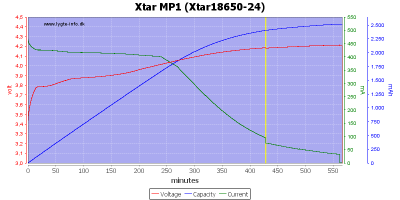

05 Feb 2014 01:45 por antiparanoico
Re: cargador xtar mp1s
"Yo y solo yo..." prefiero aprovechar toda la capacidad...
El MP1 puede hacerlo...
At about 4.18 volt 90 mA charger current the led will change to green, but the charger will continue to charger until the current is below 33 mA.
Pero...
The charge curve shows a approximation to a CC/CV charger, but it starts reducing charger current at 4 volt, instead of 4.2 volt, this increases the charge time. It will also say "end of charge" before the battery is fully charged, this makes it possible to get a nearly full (95%) battery "fast", but there is missing some visual indication of when the battery is fully charged.
A new LiIon cell with a low internal resistance. The charger say ready after about 7 hours, but does first stop charging after about 9 hours.
Si demoró 9 horas para cargar una 2400...
